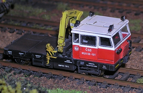

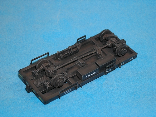

Here are some photos of my new MUV 69 in HOe. The chassis is from a Minitrix Docktank with the back two axles removed. I have then added half of a bogie from a Lifelike American diesel so it picks up electricity from all four wheels! I will put some more (hopefully better) photographs as it progresses.

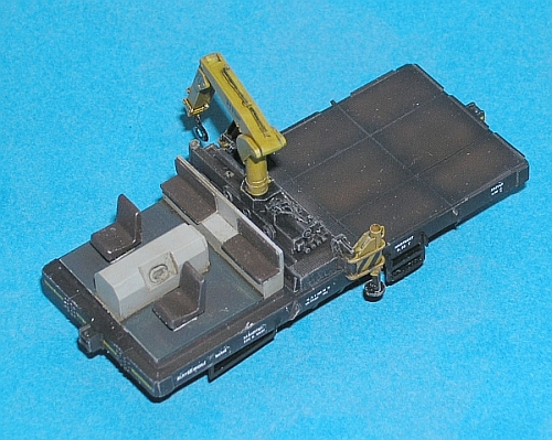

More progress...
